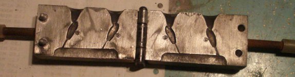

so did mr. ament press these custom molds? I'm looking at his pin setup and can't help but think theres a reason for them both being on the far side from the hinge. just thinking that maybe my hinges being so close to the one pin on that one side might be causing my hairline gap on the hinge side, being as that pin is sort of comming into it's hole at more of an angle, causing a prying action against the hinge, possibly letting my hinge get out of adjustment. anyway I love those old school molds, if only they could talk.

took the new mold and loaded two vmc size 6 hooks in it and took a little sinker and put it into a stirring ladle and heated it up with an alchohol lamp, when it melted I poured it into one of the sprue holes, and then opened the mold, what I saw was a perfectly formed head with absolutely no flash, I closed the mold and poured the other cavity the same way, same result, beautiful. I don't know why this head and mold got me so exited but it did, took the two heads and clipped off the sprues and tied them both up in one of my favorite color combos, yellow, black and red thread.

crappyhappy, thank you very very much for posting the pics!!! fatman, I didn't have the lead to load the pot with so I had to make due with what I had, lol surprised me how well the jigheads poured with no air pockets etc. this way, honestly I didn't expect it to work very well, learn something every day, and believe me it looked like ol tire weight lead when irt was in the ladle, all rough looking and not shiney. so I can only imagine the results with good lead, but for now my sinkers are in real trouble. lol can you believe, a perfectly clean jighead with no flashing or seams from a homemade mold. I'm beside myself

redear Just saw the pictures and you have done a wonderful job. You have almost duplicated the head that I made 30+ years ago.
Paul Ament didn't always put his pins on the handle side. He would I believe study the blank and then determine where they needed to be. The custom swim head he did for me has the pins one by the handle and on by the hinge.
I think that you have passed me up there buddy and now I need to start asking you for advice.BTW some of my molds I don't have any handles on I use a pair of pliers to hold them together. Originally we fitted a Lee loader bullet mold handle on them but found our quickly that it was faster to us a pair of pliers.
