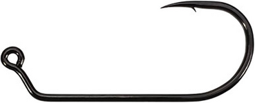

All Victory jig hooks appear to be shameless knock offs of other brand hooks except for this V10360.
Altho most V hooks are comparably priced with their other brand counterparts this one is pricey maybe because this style appears to be an original exclusive to Victory. I really like the V10360 in 1/0 & 2/0 being narrower gapped and slightly lighter wire replacing Mustad 32786 NPBN. Haven't wet them yet but looks ideal for pinning 3" soft baits for inland warm water species as big as they get.
All Victory jig hooks I've gotten have been optimally sharp and strong, but some hook fits have been a problem with eyes not exactly fitting the mold slots designed for the original fit other brand hooks. The V10360 2/0 had to be slightly shank bent to fit my 2/0 32786 molds..
Not sure if it will be a recurring problem, but two 1/0s snapped attempting shank bends. Hope not cuz I dipped for a box of 1,000.

Tried the V10360 1/0 in 1/8 Hooksups and 2/0 in 1/4. They work fine sticking fish but the points fold too easily contacting rocks for my liking. Not uncommon to have to re-sharpen the same hook many times after even light hard bottom ticks. Been so annoying I quit using them & have switched back to Gamakatsu full time which are way more resistant to point folds.
I suspect the other Victory hooks I got will have the same problem.

I purchased some v10360 1/0 jig hooks and after painting several of the hooks broke at the top of the hook eye while cleaning paint out of eye with my half hitch tool. Happened with some #4 and #6 Victory sickles as well. Never had broken a hook there before with any hook. Very disappointed with the 10360 hooks and won't be ordering them again, high priced junk hooks. Reluctant to use the ones that didn't break.

Victory jig hooks look great, well shaped and finished, finely honed sharp points and finger test bend out resistance seems good. Curious that the steel apparently high carbon and hard tempered to brittleness should also be prone to minimal force point folding.

If excessively hard tempered, the hook will snap under pressure like the V10360 I attempted to pull out of a snag today.

Gamis do break, 604 twice recently on fish fights and once fixing a bend out. So, since I got a whole box of Victory 10360 1/0 decided to give em a fair shake. Last night & night before same jig head pinned with half Gulp troos Sinking Minnows 13 catfish most 7-10# with a few 20#+. Was careful not to hang bottom so only had to resharpen once. Hook stuck and held excellent, only one drop off & after all those heavy tugs & a few bottom snags barely noticeable very slight bend out not enuf to affect performance. Guessing that the breakers might be hopefully few and far between, further testing required. The original needle point folds easily, resharpened not so much.

Two more catfish sessions using V 10360 1/0 heads. Another slightly bent out on fish fights head still functional with no drop offs, and another broke instead of bending out on a terminal bottom snag. Hard bottom snag point folds continue to be annoying, but back in bizness after a quick touch up with an Eze Lap.
So total 4 sessions 36 cats lots of chunks including several 20#+ on 3 V 10360 1/0 hook heads 2 slightly bent out retired and one broke on snag. No fish lost due to hooks failure.
Final comments - Mustad 32786 NPBN also prone to point folds and unnecessarily heavy wire for my fresh water apps. Prefer the narrower gap of the lighter wire V 10360 so it will have a place in my arsenal of 60* heads. But as JungleJim mentioned overpriced at almost double the cost of 32786.

Been using Victory hook jigs more lately, mostly 10360 1/0 and 11413 #2 and am starting to really like them. Both are unique with no other brand alternates available. No abnormal bend out or breakage problems, both stick and hold as well as any and serve my preference for heavier wire hooks. As mentioned all sharp hooks including Gamakatsu will point fold on hard rock snags and after the first touch up hone the Victory points are a bit more resistant to folding.
Want to get more 10360 2/0 but not willing to pay $30 per 100. The 11413 #2 & #1 are reasonably priced at $13 per 100, likewise the 11635 2/0 $15 per 100.
