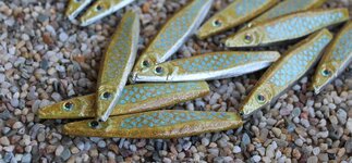

Golden Olive
1 APP`s 24K Gold (candy)
1 Rosey´s Candy Psycho Lime Green
1 own mix of gold orange
Gold orange:
- lot of gold sparkle
1 Brass Transparent
2 fluo yellow
2 fluo red
5 clear
More clear might be good, but I´m quite happy with it as a sand eel color for my tins. Looks very natural, with a light uv-response.

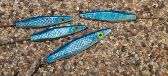

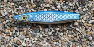

I´ve given up the search for a fluorescent blue PP. Thought I would mix it with candy and clear anyhow, so I got myself some UV Blue pigment from a local supplyer. Costed me an arm and a leg but can be used very sparsely.
Deep blue:
-1 part uv blue pigment (or less)
-2 parts Rose´s candy blue
-5-8 parts high gloss clear
- good deal of blue glitter

Where would a guy in the States look for the Blue Pigment you used in this? It's really a great color with outstanding glow!
Bucho
Mar 29, 2013
919
Kiel, Germany
Sorry, I can only point out the source I got it from:
http://www.uv-elements.de/shop/en/categorie/Tagesleuchtpigment?cat=50
This kind of stuff is usually cheaper and better available in the States, but if everything else fails I`d be happy to make contact or forward it to you. They use DPD for their local customers but DHL who cooperates with USPS has surprisingly low rates for shipping to north america. Prices include 19% VAT which might be deductable/not apply.
